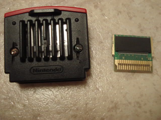

to clarify, you're talking about the memory expansion pack that you stick into the top of the N64?
I don't have the dimensions on hand, but this is the PCB cut down and compared to the pack it comes in.

Post by Neildo_64 » Wed Nov 26, 2008 5:48 pm
At the bottom where the contacts are, it is 3cm wide. You can chop the height down to 24mm (2cm max but makes for very tiny soldering) if you're soldering it in place and ~27mm if you want to leave the contacts on the bottom there to plug it in. I don't know the unchopped dimensions but hopefully this helps. There are a few nice scans around somewhere around here, but you'll have to search around, they are kind of hard to find.
On third party exp paks, they are taller because they use two 2mb chips instead of one 4mb chip.
